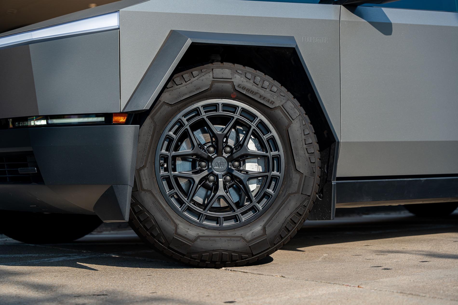

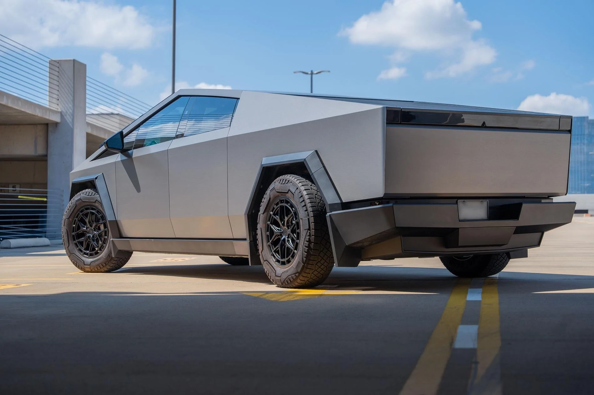

Thanks to @getsometom for reviewing our [AW09] rims for the CT.

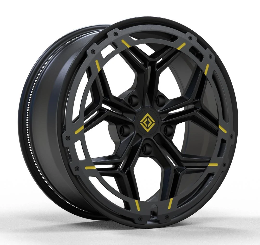

This new design is called [AW08], this render is for Rivians, we will adapt to the CT soon. This wheel has an increased payload of up to 1400 kg vs 1170 kg for [AW09] and [AW10].
Tesla Model 2 Fully Forged Atomic Wheels for Tesla Cybetruck 8103678582777a09bee3625d6029d2e0
Additionally, the valve doesn’t protrude, making the rim more off-road capable. The center cap will have a CT silhouette. This render is for 20”, and we will also offer this design and [AW09] in 18”.

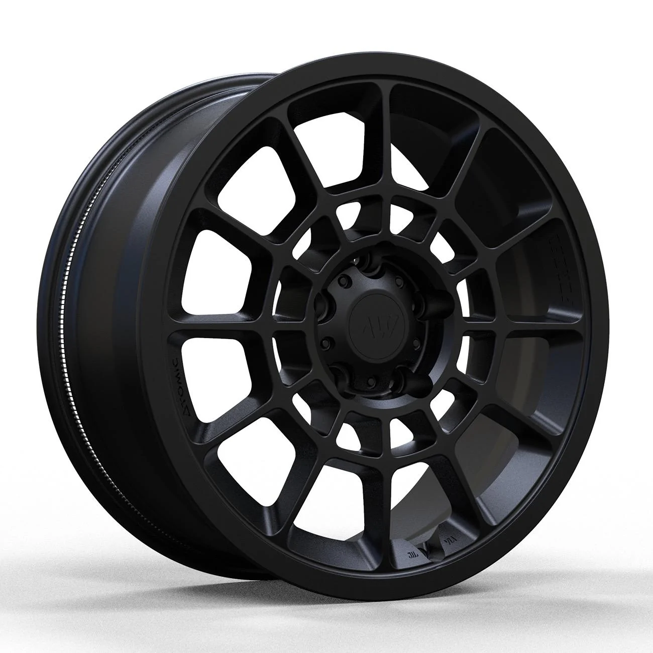

I love the custom wheels, that’s awesome. But let’s take a double check at load ratings. I believe our trucks need 2,650 load rating minimum. GAWR 5,247 divided by 2 is 2,623lbs. Am I the only one who thinks this as an overlooked detail?
gemgem
Gem
Jul 19, 2023
Dallas, TX
Tesla Model Y Performance, G63
Why not match the CT center bore? Obviously these must be lug centric, but seems odd if you're custom making them to fit the CT.
...Because they didn't know the centerbore of the CT to begin with! "Experimenting and picking random centerbores" ?‍♂ Lugcentric is a NO NO. Even more dangerous on a truck with a gross vehicle weight rating of 9,169lbs! Inevitable for a stud to snap.
Tesla Model 2 Fully Forged Atomic Wheels for Tesla Cybetruck img_0447-
PSA: Another company manufacturing in China with little to no knowledge about wheel engineering.

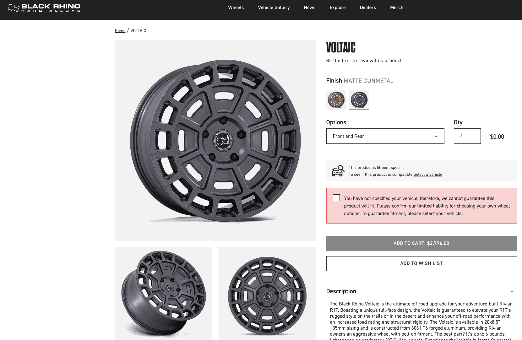

What is this? A dead copy of a Black Rhino Voltaic Wheel? Shame on you @Atomic Wheels
Tesla Model 2 Fully Forged Atomic Wheels for Tesla Cybetruck PNG imag
Tesla Model 2 Fully Forged Atomic Wheels for Tesla Cybetruck Screenshot 2024-07-02 at 11.39.54 AM
Black Rhino manufactures in China too, but at least their spec is dead on for the vehicle application.
@DeadSetElectric You're 100% right. Their stated load rating is underrated for a CT. Forged or not. Even the factory 20" wheels have a higher load rating. Load should never be overlooked, especially with a truck this heavy.

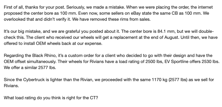

First of all, thanks for your post. Seriously, we made a mistake. When we were placing the order, the internet proposed the center bore as 100 mm. Even now, some sellers on eBay state the same CB as 100 mm. We overlooked that and didn’t verify it. We have removed these rims from sales.
It’s our big mistake, and we are grateful you posted about it. The center bore is 84.1 mm, but we will double-check this. The client who received our wheels will get a replacement at the end of August. Until then, we have offered to install OEM wheels back at our expense.
Regarding the Black Rhino, it’s a custom order for a client who decided to go with their design and have the OEM offset simultaneously. Their wheels for Rivians have a load rating of 2500 lbs, EV Sportline offers 2530 lbs. We offer a similar 2577 lbs.
Since the Cybertruck is lighter than the Rivian, we proceeded with the same 1170 kg (2577 lbs) as we sell for Rivians.
What load rating do you think is right for the CT?

OMG...are you serious? You got your original centerbore data off EBAY?! And now you're asking the community what we think the right load rating is? You're the wheel company, shouldn't you know?
@Unpluggedperformance @Tsportline @MountainPassPerformance this company basically just eluded they'll copy any wheel a client's request. Not cool.

We didn’t get the center bore data from eBay but from the website of another US wheel company. Yes, it was a mistake.
I mentioned that the CT is lighter than the Rivian, and the wheels for Rivians have a 2500 lbs load rating. That’s why I asked for your opinion. We’re using the same payload as for Rivians due to the CT’s weight. Additionally, we are launching a 3080 lbs version soon.
