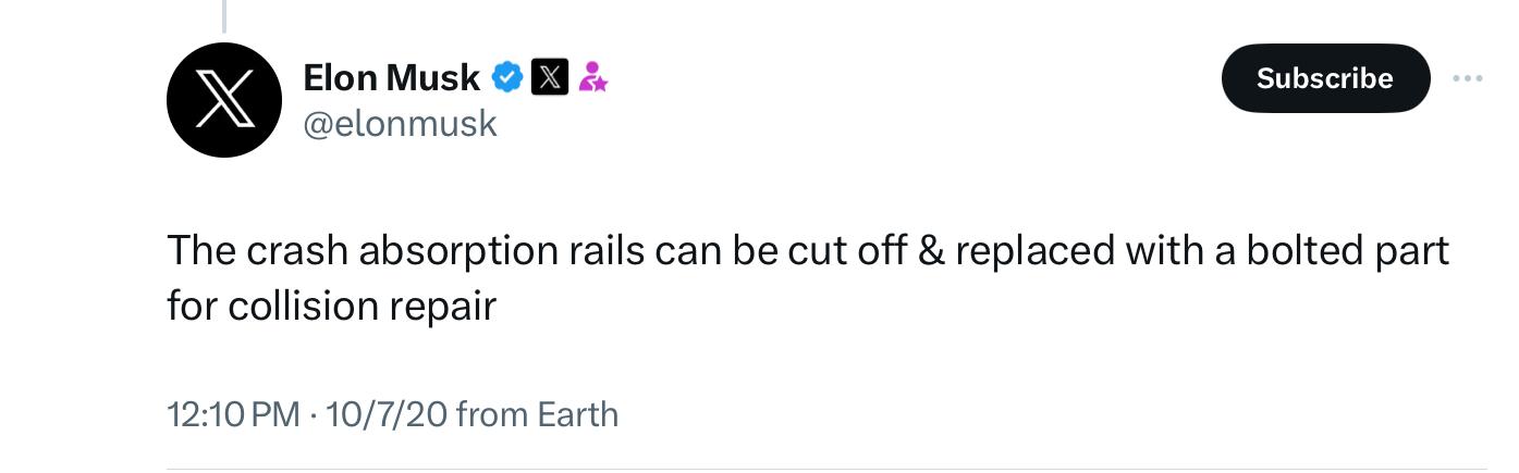

If you would identify what the crash absorbsion rails are, you would know they aren't a part of the cast.
Give me cast specific info and I'll beleive you. The front crash tubes are only good for impacts up to 5-20mph if both are impacted evenly, like on any other modern car.
With a cast you can't tell where it has microfractures, without complete disassembly and a specific x-ray machine.
I don't recall indicating that the crash absorption rails were part of the castings. In most vehicle collisions regardless of ICE or EV where the damage goes beyond the absorption rails the vehicle will be totaled out by insurance.

Link to videos below. First off, Tesla isn’t using a generic aluminum, and with the gigacasting, the possibility of cracking is greatly reduced. He mentions he spoke with a supposed expert and the recommendation for THIS type of aluminum when cracked, is to weld it. One of the things he points out is the crush zone surrounding the casting. Before the impact gets to the casting, there are body parts to protect it. And he makes the comment that a standard unibody (sans castings) is more likely to be written off than a Tesla, because a unibody spreads the impact out in areas that may make the vehicle unrepairable. In another interview I saw, Tesla was talking about how their design team works WITH the production team AND the repair team when they are designing the vehicle. So when the vehicle rolls off the line, they already have an idea of how to fix it.
Then we have Elon’s tweet. He directly says you cut the bad part off (using a Tesla supplied jig) and bold the new piece on.
The last is Sandy (and a sledge hammer) showing the difference between welded steel and a casting. It certainly is eye opening.
I think the take away from all this is that there is a whole lot of FUD about the gigacasts, and that is being stoked by detractors, when the truth is, it is safer. And in the long run, that is ALL that matters.

So which is it now, are you writing off cars with damaged casts, or welding them to repair them?
Or welding them to write them off? Lol. What a bunch of ill informed forum jokers...just stop making up stuff up and research a bit before making stuff up.
The whole point of the different size webbing on the cast is for progressive absorbsion of energy along the load path. That means impact energy is disipated by deforming the cast (or crush rail under 20mph) like a compressed spring, along it whole length.
There is no welding technique in the would that can "un-compress" the cast.
The crush cans are on the front of the casts, and can be replaced. You can see them. It's not only on the non-cast assemblies.
Maybe you guys missed this from the horses mouth:
