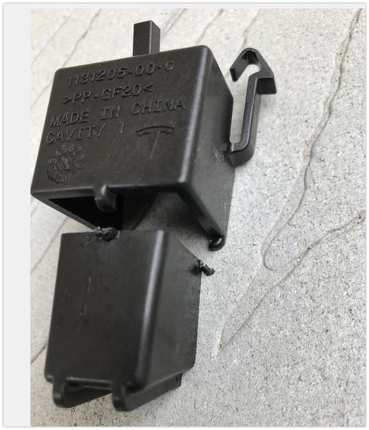

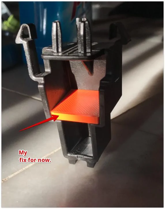

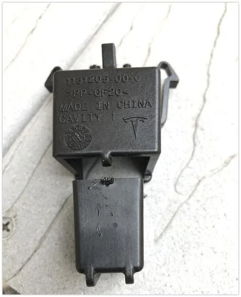

(I Posted in another site June 22 2019 for Tesla Model 3 )I was removing panels in the Frunk area near the 12 Volt battery/air inlet. I found Part Number 1131205-00-C >PP-GF20< , broken and seems to be poorly designed. The Assembly, which has two parts is joined by a (3) very slim tabs of material which its not structurally strong enough to hold up to pushing a panel fastener in and not allow the panel to be fully fasten. You may what to check yours (theirs (2) of them. (Needs to be redesigned)
