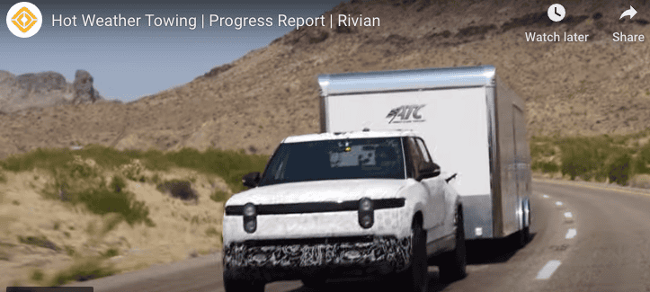

Rivian has released a video of the towing testing for its upcoming R1T electric pickup in some insane 118º F heat.

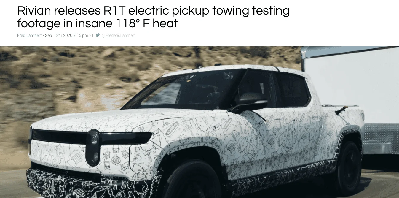

We are seeing a trend lately of companies planning pickup trucks showing the capacity of their trucks as the race to bring the first electric pickup to market heats up.
Yesterday, Ford released testing footage of its F-150 electric pickup prototype and a day before that, GM unveiled footage of its Hummer EV electric pickup testing its ‘Crab Mode’ feature.
These electric vehicles are still a year away, but automakers are working hard to validate them and bring to production.
Now Rivian, who is also trying to bring to market an electric truck on the same timeline, released a new video of its team testing the towing capacity of its R1T electric pickup truck in some insane heat:

It's cool to see them testing but this info was hardly relevant to what we need to know in the real world.
For example they state that they easily exceeded their (ridiculously low) "maintain 40MPH" up a grade. But they didnt say by how much or what speed they were able to maintain. I'd HOPE they were able to maintain at least 60MPH.
Also it doesnt really say how much range was reduced by towing or under what conditions. They said it was about 50%. But it's really important to know what flat towing vs hill towing does to range. If hill towing crushes a battery by 80% then that's really really bad. Whereas if flat towing only reduces range by 20%, that's hardly a dent. Or did they see that 50% reduced battery range consistently regardless of terrain type? All this scenarios require different evaluations on vehicle capability
It's really aerodynamics that you'll see the biggest change, because that's the biggest multiplier. So knowing the speed is essential. Weight is really very secondary to drag with modern vehcles.
And with an EV being so efficient normally, bad drag will just be really easy to notice. The big brick of trucks will see less towing drop because they're already so inefficient.
So really you want to ask... "What was the speed, wind, and temperature?" Cold air means 20% more dense which means more drag. Like, 50% more speed can more than double that base aerodynamic drag... Which is then multiplied by how dense the air is. And that's air speed, so going 40mph into a 20mph wind is like driving 60 which means you've doubled your air resistance (sort of, it's a square law).
